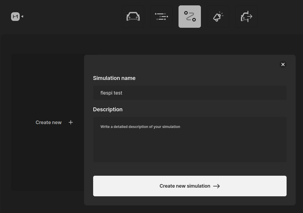

High Mobility is a platform designed to normalize and centralize vehicle telemetry and status data from various OEM sources into a single, consistent API. It abstracts away the complexities of disparate OEM data formats and communication protocols, providing developers with a unified interface to access vehicle information like CAN bus data, sensor readings, and vehicle state.

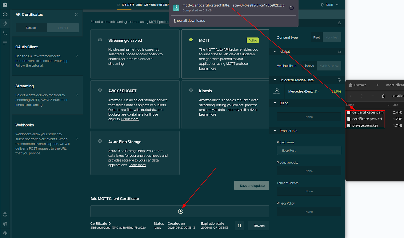

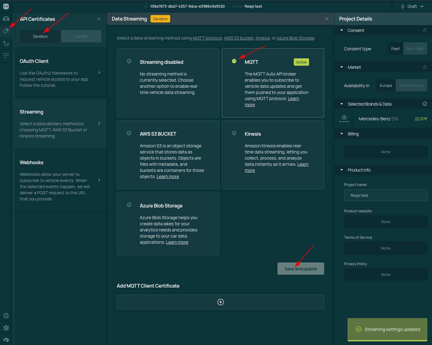

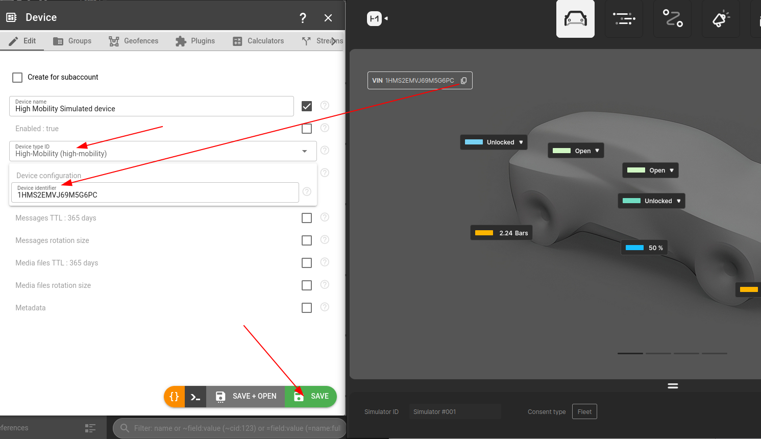

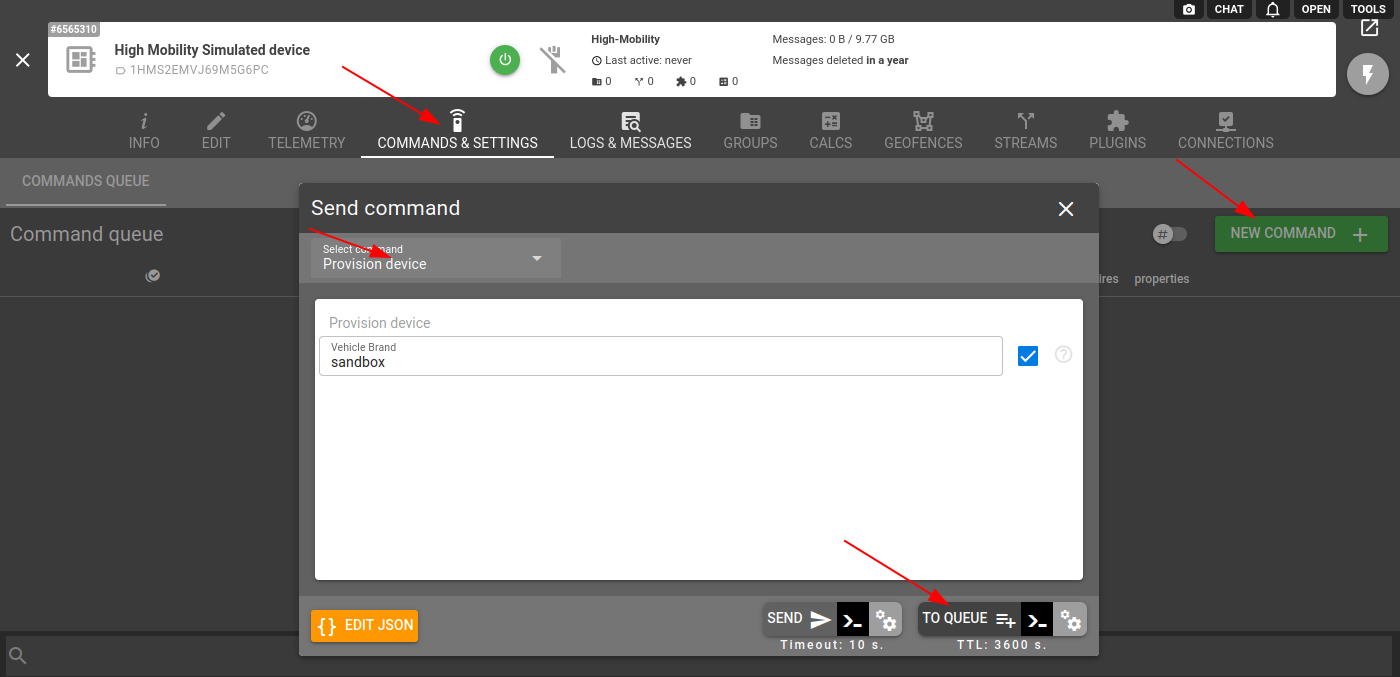

This guide walks you through the process of connecting TEST data streams from High Mobility to flespi. To connect live data from real vehicles you need to sign an agreement with High-Mobility. The price depends on the amount and diversity of data that you get from your OEM vehicles.

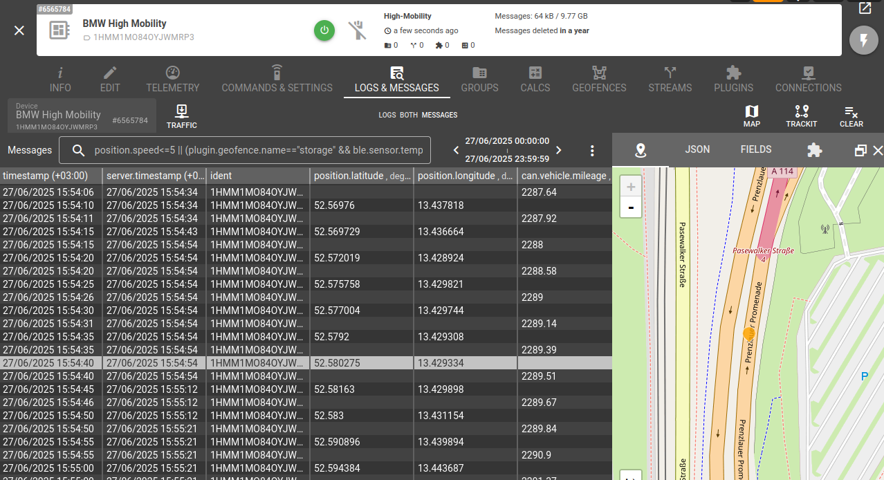

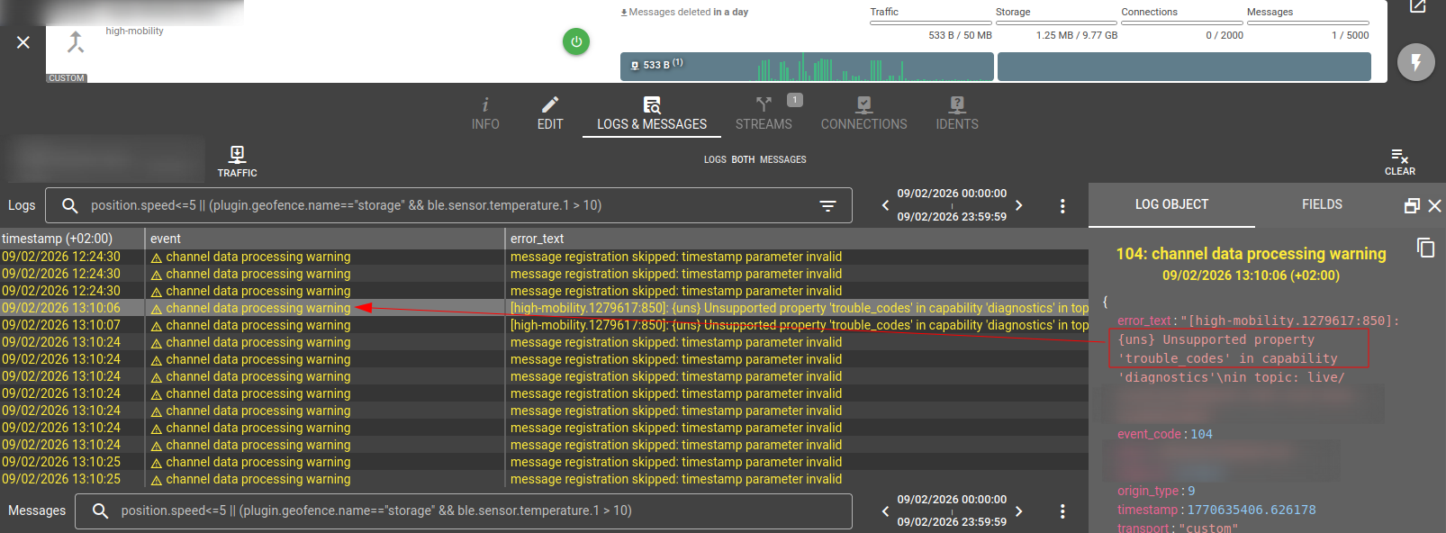

flespi supports new message parameters on demand. If you have successfully set up data flow and see warning logs like these - please contact flespi team and we'll add them to the parsing scheme.
