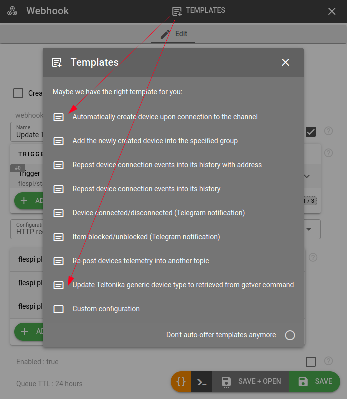

Both webhooks are available in the Templates section when creating a webhook, so you can deploy the complete workflow without recreating it manually.
