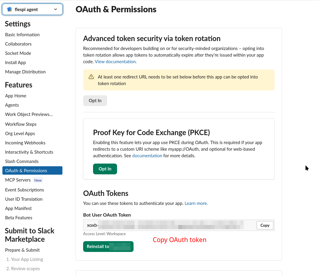

  1. Install to Workspace, then copy the bot token (xoxb-…) from OAuth & Permissions:
    copy the slack bot token

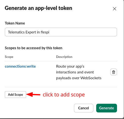

  2. On Basic Information → App-Level Tokens, generate a token with the connections:write scope and copy the app-level token (xapp-…):
    generate the slack app-level token

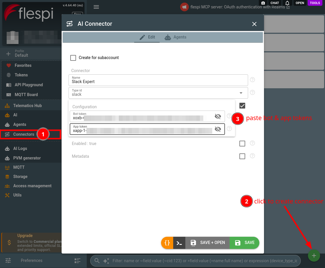

Both tokens go into the configuration of a new connector of the slack type:
create a slack AI connector

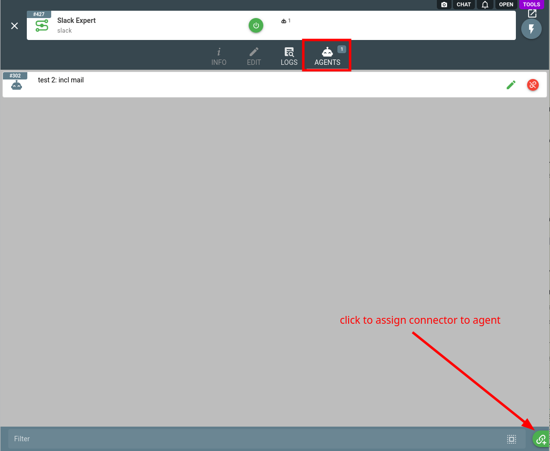

Assign the connector to your agent (create one if you have none yet) from the agent's Connectors tab, the connector's Agents tab or with Connectors and rules… in AgentBox:
assign the slack connector to the AI agent

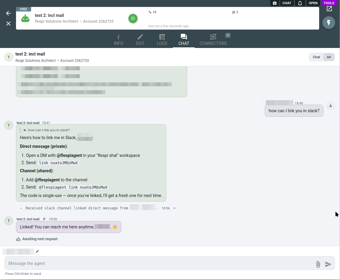

Conversations are not configured: they link to the agent with a one-time code. Ask the agent to connect and it hands you the code:
ask the AI agent for a slack link code
Use the code in the conversation you want linked:
  • direct message: open a DM with the app and send link {code}
  • channel: add the app to the channel and send @app link {code} there
The code links the conversation right in Slack:
link a slack conversation to the AI agent
Codes are single-use, expire in one hour, and a fresh code replaces each used one. Treat a code like a key: whoever uses it links their conversation. The first person to link becomes the agent's principal.

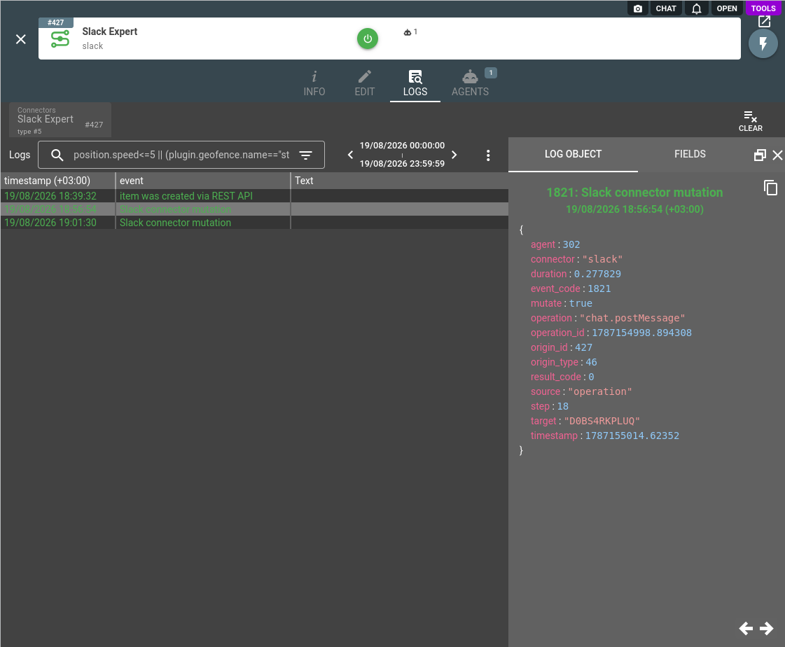

Channel traffic lands in the agent conversation history as slack_message_received and slack_message_sent records, channel link changes as slack_channel_linked and slack_channel_unlinked, and every Slack API call the agent performs is recorded in the connector logs with the operation, target, and result:
slack connector logs with the agent operations
