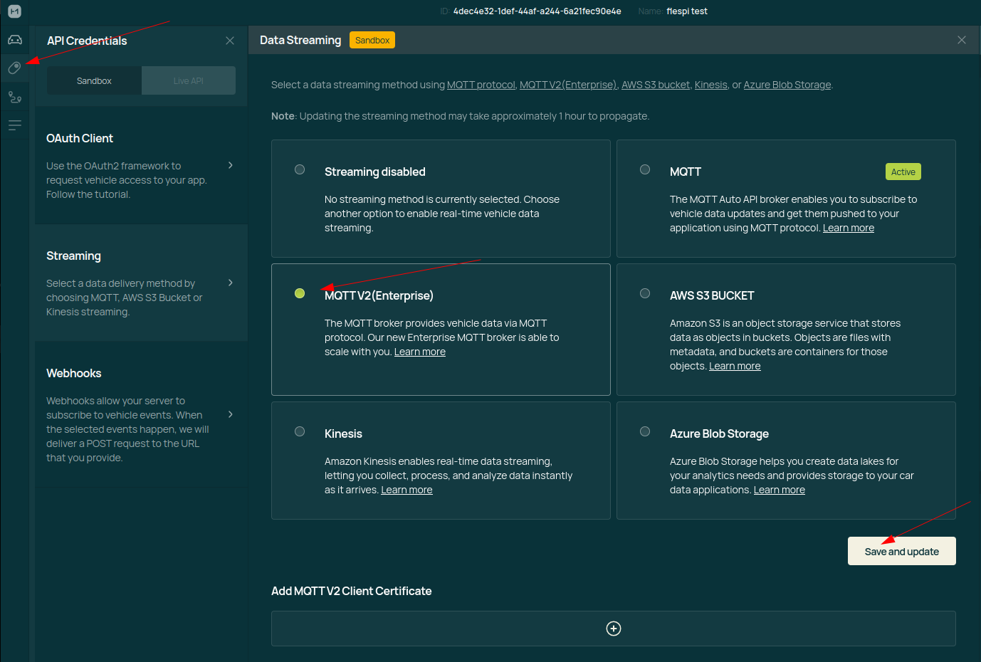

Step 4. Create MQTT Streaming. Note: use MQTT V2(Enterprise) option.
Step 5. Create an MQTT Client certificate chain and download it by clicking on a "+"  button under Add MQTT V2 Client Certificate section.

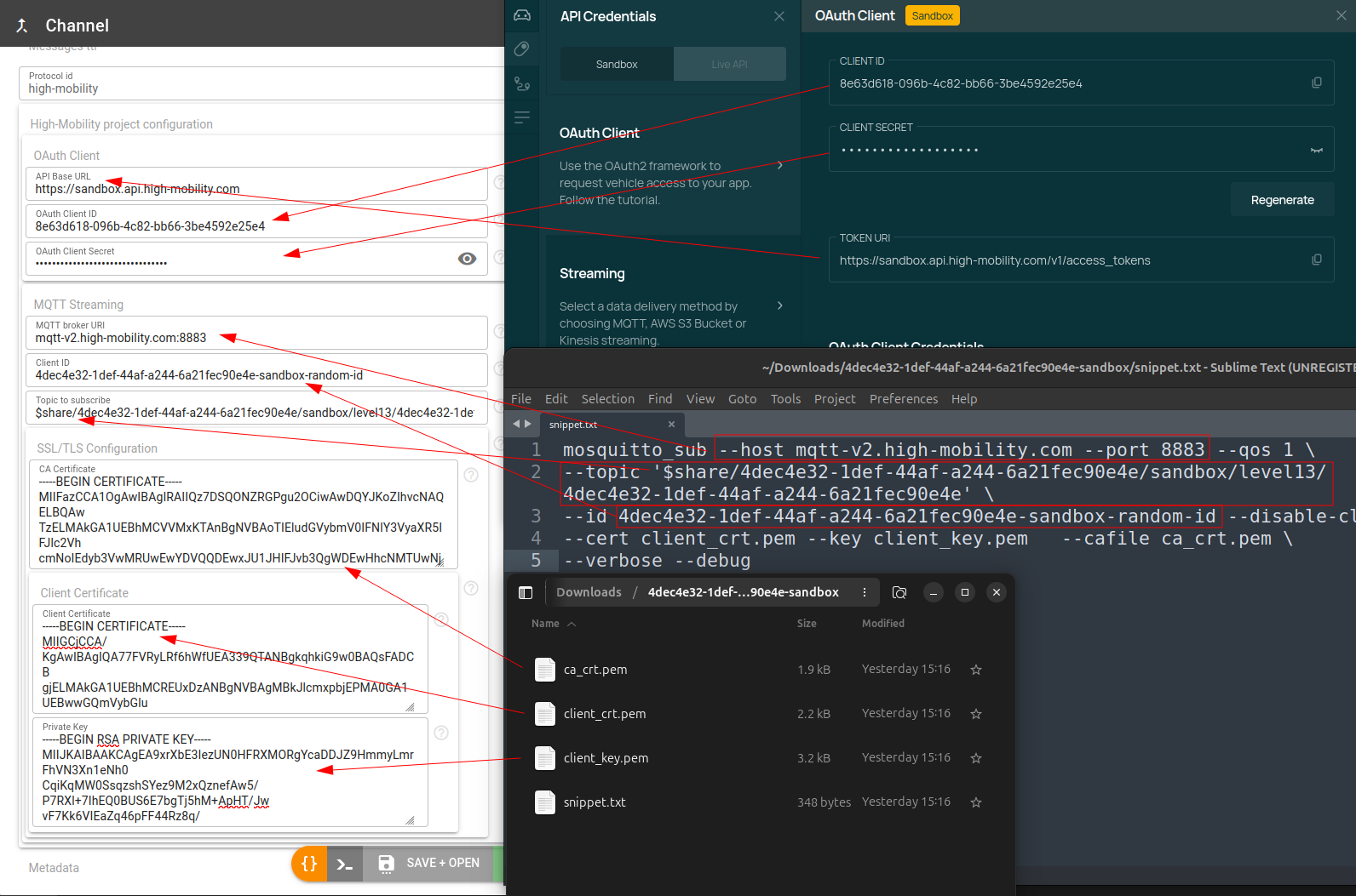

Step 6. Now we have all the data to create a high-mobility channel at flespi: go to the flespi dashboard, Channels -> Create new channel -> Select protocol “high-mobility”.
  • From the OAuth Client, copy Client ID, Client Secret, and get the API base URL in the format https://sandbox.api.high-mobility.com/ (without v1/access_tokens).
  • Open the snippet.txt file from the certificate chain archive and copy the MQTT Broker URI, Client ID, and topic to subscribe. Open the certificate files in the downloaded archive and insert certificates values and key values into the appropriate configuration fields.

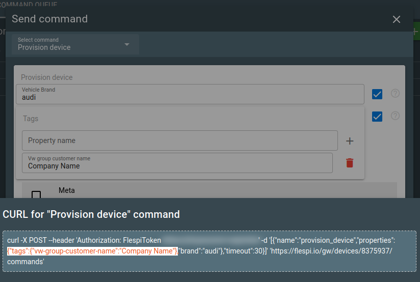

Step 9. In the created flespi device, go to Commands and Settings -> New command and select the “Provision device” command, and execute it by adding it to the queue.
for specific car brands, the provision_device command might need to have tags. E.g. VW Group brands require the tag vw-group-customer-name with the company name as a value.
In general, provision_device command under the hood is Create a clearance method from High-Mobilily REST API. You may contact High-Mobility support to figure out exact request format.
