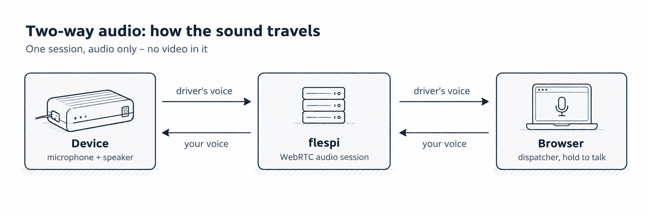

All three are sessions in their own right, and that is worth making clear, because sound can reach you in two different ways. A live video stream can carry the device microphone together with the picture, which is handy when you want to hear what is going on while you watch. But there is no way back through it.
Talking is a separate session with its own command: no video is requested from the device, no video is converted, and the traffic costs are closer to a voice call than a video stream. On a truck with a metered SIM, that is the difference that matters.

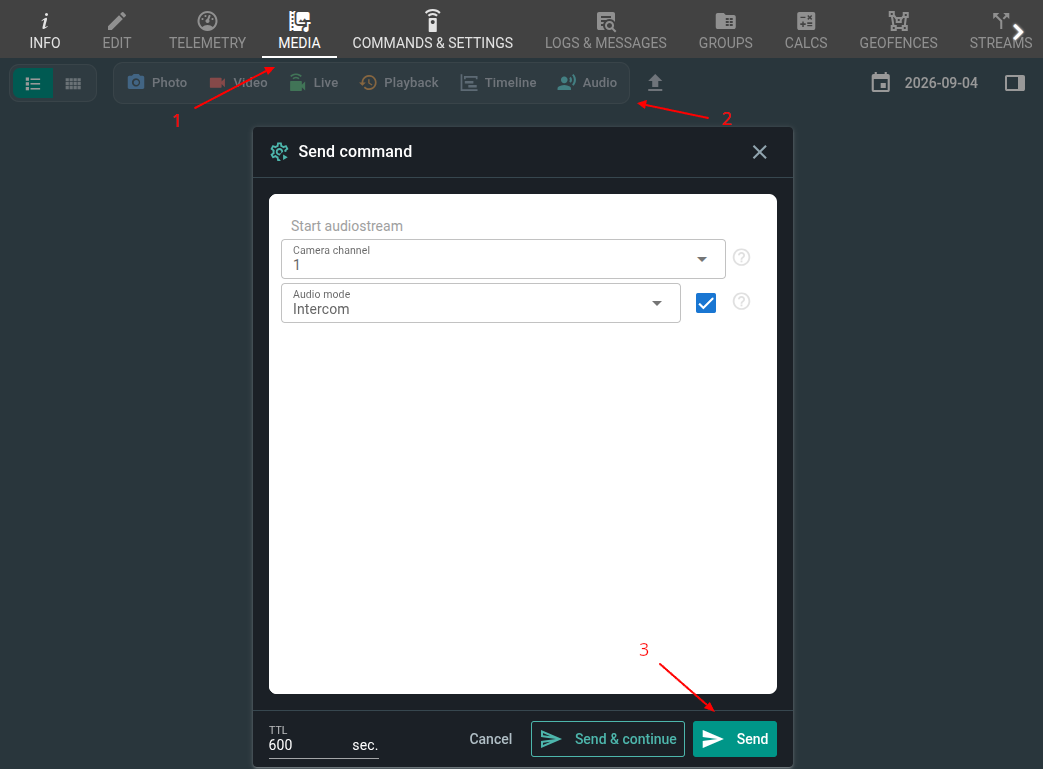

To start an intercom session, go to the dashboard, click on Media > Audio > Send. Also, you can use the following request with a payload:
POST https://flespi.io/gw/devices/{device_id}/commands
 "name": "start_audiostream",
 "properties": {
   "channel": 1,
   "type": 1
 "timeout": 30
The type property selects the mode – listening, intercom, or broadcast – while channel selects the audio channel of the device. The command completes once the stream is ready, and the response contains the address to open:

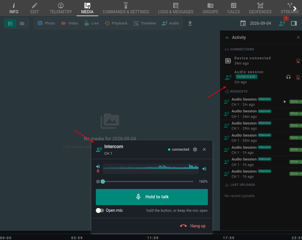

There is nothing else to switch on: in intercom and broadcast, the return path is available from the moment the session starts. Point a player at that URL, and you are connected. In the flespi panel, the same session is one click away, with the talk button right under it.
Push-to-talk, by design
The talk button is not there to look like a radio – it is how the feature is designed to work.
A vehicle cabin is a small room with a loudspeaker and a microphone in it. When the dispatcher speaks, the device plays that voice into the cabin; the microphone picks it up, and it goes straight back up the channel. So the dispatcher hears their own voice come back a moment later, which makes a conversation difficult.
This is why the player works like a two-way radio. Your microphone reaches the device only while you hold the button, and the incoming audio is muted while you speak and for a moment after you let go, so the echo of your own voice never reaches you.
Only one operator can talk at a time, and the microphone is assigned at the moment of connection: the first viewer who asks for it gets it, while everyone who joins later connects as a listener, with no way to send audio. The microphone is released when the speaker disconnects, and the next viewer to connect takes it.
If you would rather keep both directions open, turn on Open mic in the player. The microphone stays on, nothing is muted, and the session becomes an ordinary two-way call. On devices that handle echo cancellation themselves, this is the nicer way to talk; on the others, the button is the safer option.
