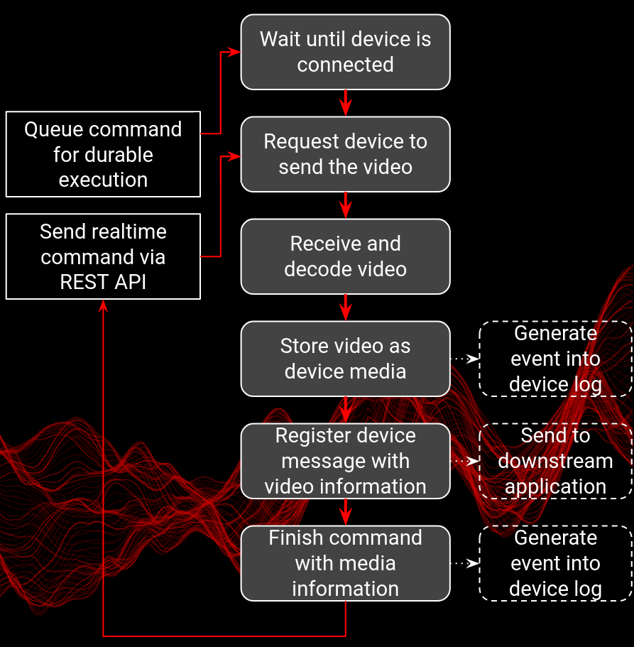

To retrieve a video clip from the remote device at a specific time, you use the standard command named 'request_video'. This command may contain manufacturer-specific options, providing fine-tuning capabilities when necessary. It always includes three standard options: camera channel index, video recording time, and clip duration. In flespi UI the time selector works in the user's browser local timezone.
The typical sequence that flespi executes when such a command is queued is illustrated below:
In most cases, a single queuing of the command via the REST API suffices. It robustly downloads the video from the device into the media storage on flespi and notifies of this action through corresponding logs and messages. A regular REST API call to queue a video looks like this:
curl -X POST --header 'Authorization: FlespiToken XXX' -d '[{"name":"request_video","properties":{"channel":1,"duration":300,"from":1701084647},"ttl":86400}]' 'https://flespi.io/gw/devices/YYYY/commands-queue'
- With this call, you instruct flespi to download video from device YYYY recorded at 1701084647 (UNIX timestamp) and duration of 300 seconds.
- This command will stay in the command queue for up to 1 day (86400 seconds) waiting for the device to be connected and be able to serve this command.
- Once the device is connected the command will instruct it to send the requested recording via the secondary connection, store this file in device media storage, and finish the command with the link to the video file in the command response.
Here is how this sequence looks in the real world. Pay attention to the order and type of events you can handle with flespi. They all reported into MQTT in real-time in corresponding topics.

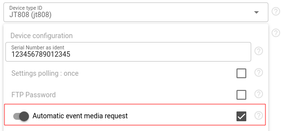

If your device allows configuration for automatically uploading photo or video data to the backend server upon specific events, flespi fully supports this functionality. Where the protocol provides it, you can send the download_event_media command (command parameters are different for each protocol) or set up automatic event media request in the device configuration (the command will be sent automatically on each event). Command's response contains json array of objects with media data (as one event can be associated with many media files).
For devices lacking such configuration options, webhooks can be utilized to automatically handle the triggering event in the cloud and subsequently request video from the device in response.
In both options, your downstream application will immediately receive the device message via stream or MQTT with two parameters:

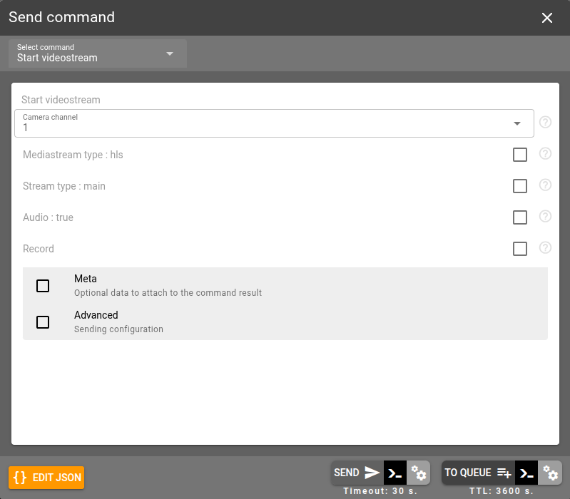

Live video streaming functionality from the device is possible using HTTP-FLV, HLS or WebRTC technology. Pick WebRTC when the delay matters and the viewer is a browser, HTTP-FLV when you need a plain link any player can open, and HLS when the player supports nothing else - it buffers the most and is the only one of the three that consumes device media storage. You instruct the device to start streaming with ‘start_videostream’ command where the most important option is to select the channel number:

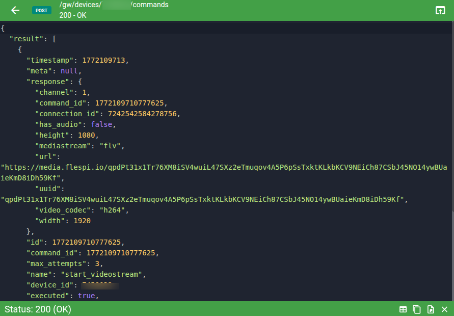

When pushed into device's commands queue, the command will await the device’s connection (if it’s not already connected) and instruct the selected device camera to start streaming to flespi with the specified quality. In this scenario we recommend using real-time commands with appropriate timeout, as this action is usually interactive and you need a response with the REST API call, providing all the necessary information required for displaying the streaming content to the user. Please note that for real-time commands you have to check device is connected first. Below is a sample call that initiates video streaming on the device and returns a link to the video stream. This link can be loaded into a media player:
curl -X POST -d '[{"name":"start_videostream","properties":{"channel":1,"mediastream":"flv","streamtype":"main"}}]' 'https://flespi.io/gw/devices/YourFlespiDeviceId/commands' --header 'Content-Type: application/json' --header 'Authorization: FlespiToken YourFlespiToken' | jq
"result": [
"timestamp": 1772107746,
"meta": null,
"response": {
"channel": 1,
"command_id": 1772107744165227,
"connection_id": 4546303783863051,
"has_audio": false,
"height": 1080,
"mediastream": "flv",
"url": "https://media.flespi.io/1L2id0BEYHFlcSx7H_d5LoOLgJydMOpfbed78mgHgi-hUNM2TLrejIEDDIq_PWT0czCK9XdD6_HjjEUBT_iXWak6sXHs5f",
"uuid": "1L2id0BEYHFlcSx7H_d5LoOLgJydMOpfbed78mgHgi-hUNM2TLrejIEDDIq_PWT0czCK9XdD6_HjjEUBT_iXWak6sXHs5f",
"video_codec": "h264",
"width": 1920
"id": 1772107744165227,
"max_attempts": 3,
"name": "start_videostream",
"device_id": YourFlespiDeviceId,
"executed": true,
"properties": {
"channel": 1,
"streamtype": "main",
"record": false
"priority": 0,
"condition": "",
"expires": 0

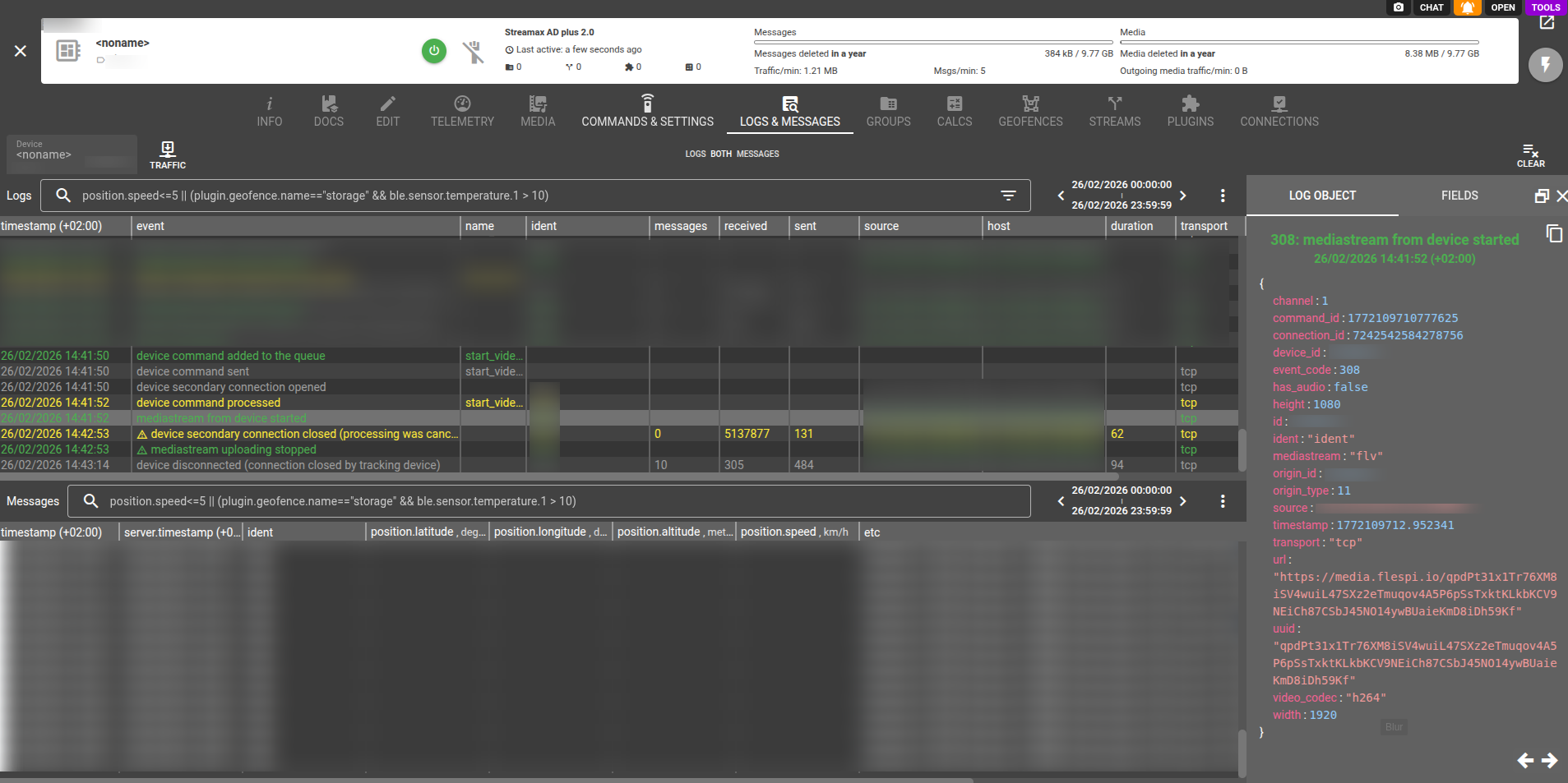

The corresponding streaming information is also accessible within the device connections. Each stream will possess its secondary connection, and you can directly access its data through the REST API:
To stop streaming, you simply delete the associated connection using the REST API. If you don't access the live stream link within 60 seconds, flespi will automatically delete it, thus terminating the corresponding streaming session. The log about accessing the media file of the stream is published to Platform logs.
You can track video streaming, whether initiated by you or other users, with MQTT subscriptions to specific device topics:
- flespi/state/gw/devices/+/connections/+: retain topic to track device connections;
- flespi/log/gw/devices/+/mediastream/+: real-time only topic to track live video streaming ‘start’ and ‘stop’ events.
