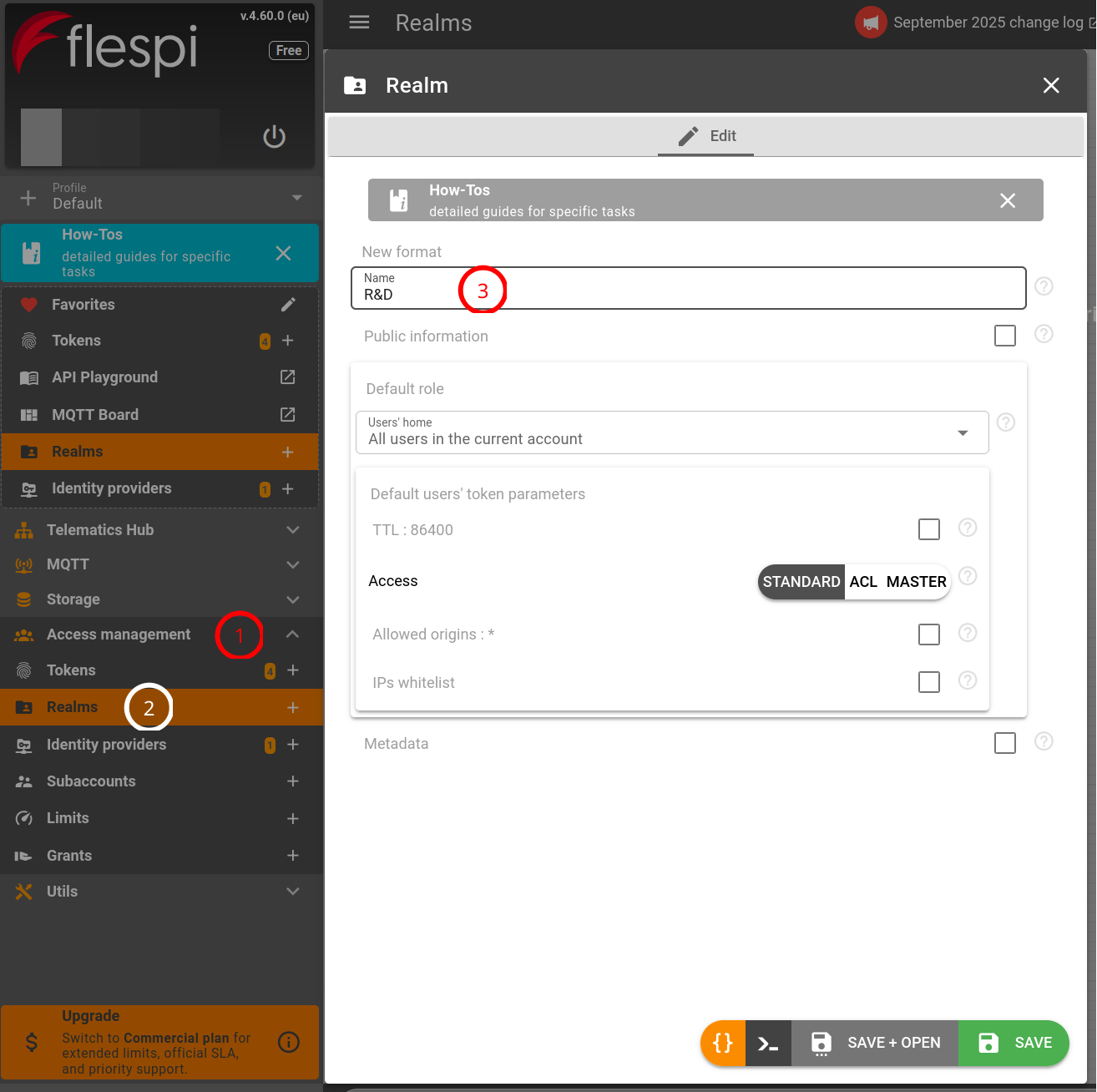

Open Realms in the Access Management submenu in the left-side menu. Click the “+” button to create a new realm. Specify its Name, provide optional Public information (name, description, and logo), specify Default role: select User's home and Token parameters. Click the 'Save + Open' button when you're done.

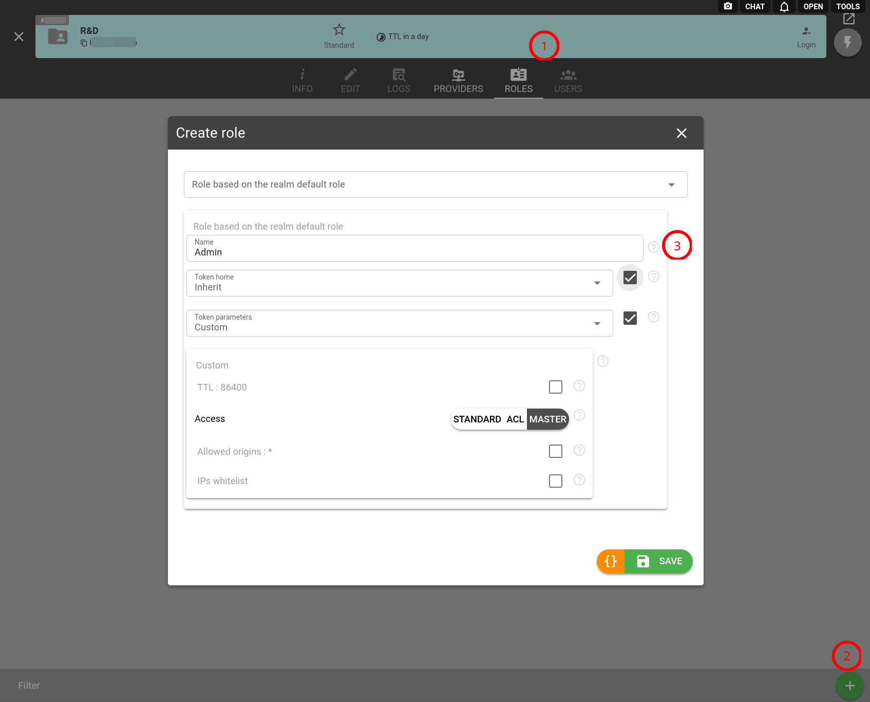

Got to 'Your realm' > Roles tab and click the '+' button to create a new one. In the pop-up window, you can choose base role for the new role (either default realm role or another custom role), specify role name and optionally override Token home and/or Token parameters. If Token home and/or Token parameters aren't specified or set as Inherit, then their values are assumed to be equal to the corresponding values of the base role. And click Save.

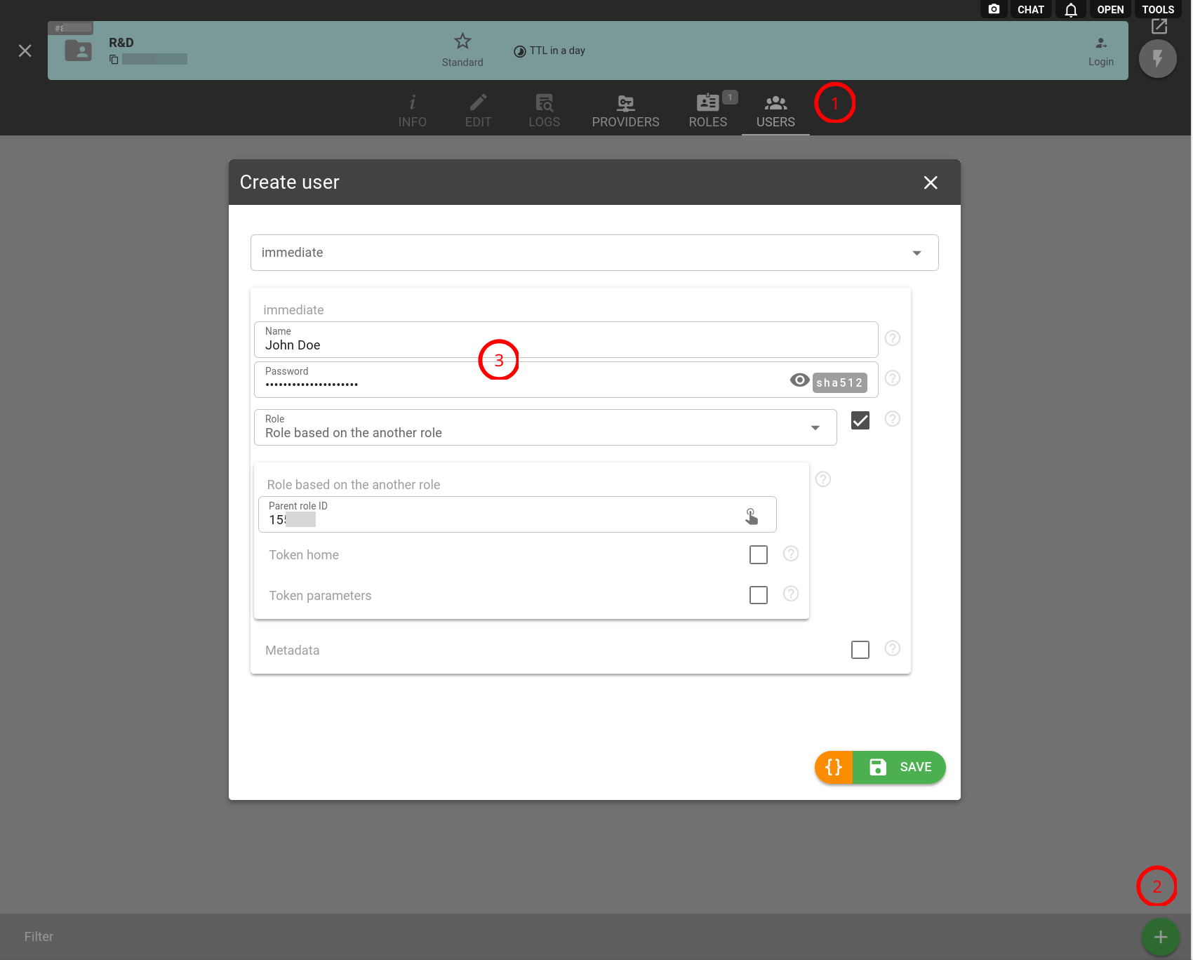

To set up a new user account, go to 'Your realm' > Users tab and click the ‘+’ button to create a new one. In the pop-up window, you can specify a username along with a password. If necessary, you can specify custom Role for an user: it can be based either on the default realm role or on the another already existing custom role. Token home and/or Token parameters can be adjusted as well as for custom roles, otherwise their values are assumed to be equal to the corresponding values of the base role. Click ‘Save’ when everything is done.
Now you need to share the realm login link with a user. On the 'Your realm' pane, right-click the 'Login' icon in the top-right and select 'Copy link address', or you can use https://flespi.io/#/realm/{public_realm_id}. When the user follows the link, the realm authentication page will appear, asking for a username and password. After that, the user will be prompted to save the token for future use.
