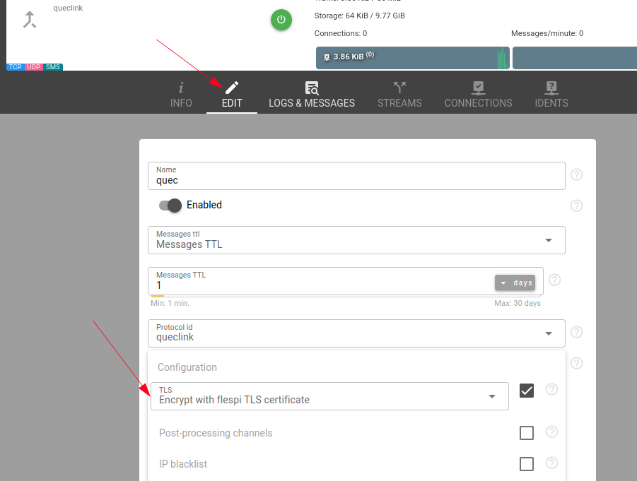

Certain device models support TLS traffic encryption. To enable it turn on TLS in channel configuration:

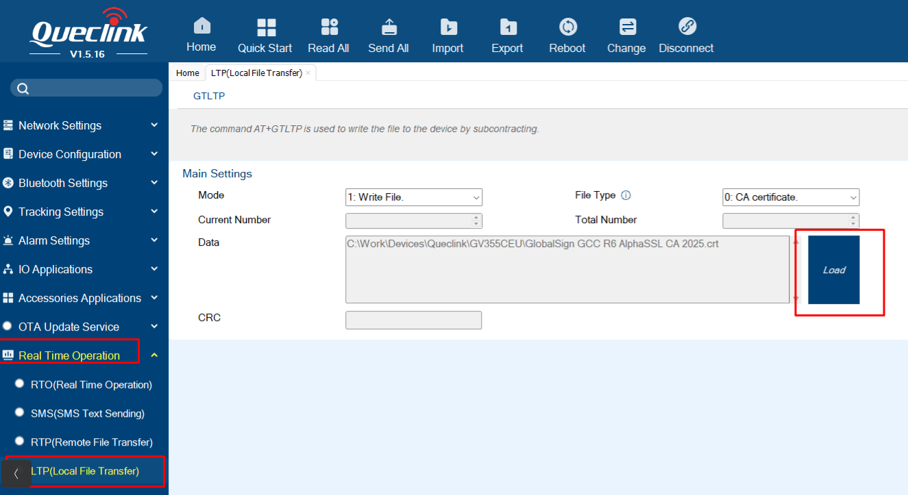

In device configuration go to Real Time Operation -> Local File Transfer and load the CA certificate (see here how to get flespi.io CA certificate) and click the Send button:

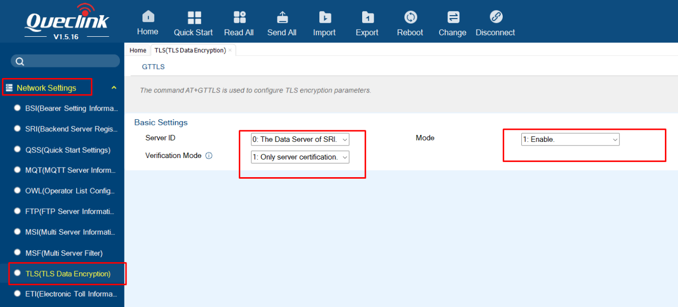

And enable TLS on device level in Network Settings tab -> TLS. Make sure to set Verification Mode to "1. Only server certification."
