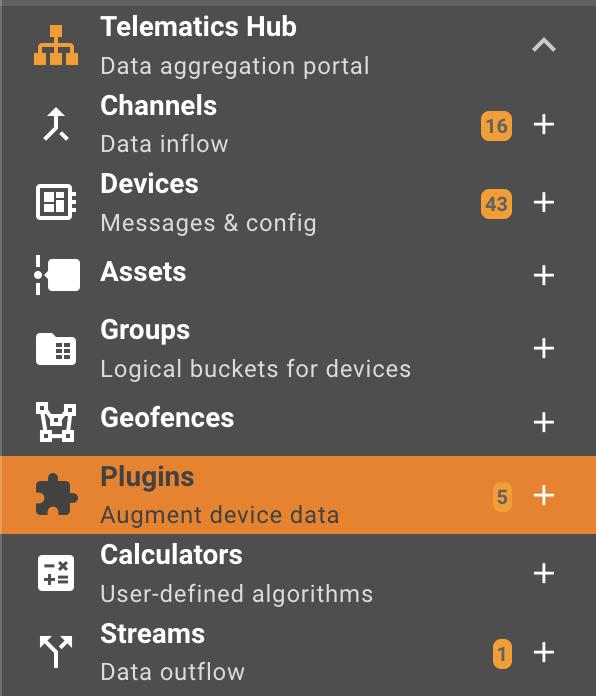

Click on the "+" button in the Telematics Hub -> Plugins section to create a new plugin:
In the window that appears, enter the name of the plugin in the Name field. In the Type ID field, select tacho-file-parse.

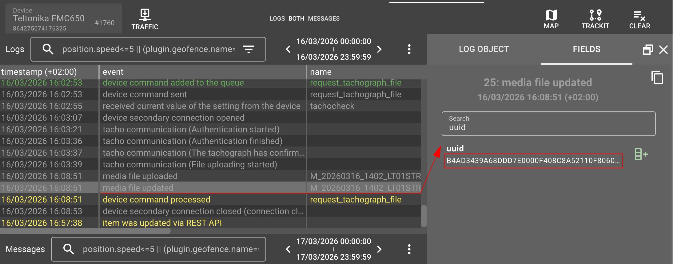

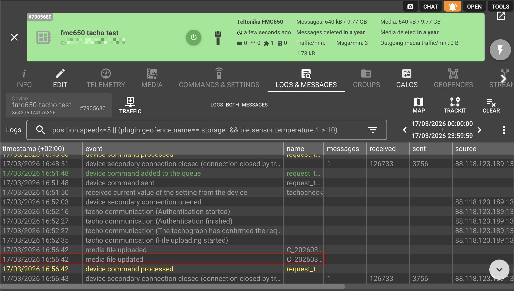

Once the file is uploaded, the plugin processes it automatically. Head to the Logs & Messages tab — a "media file updated" entry confirms successful processing. The parsed output is stored in the content field of the corresponding file entity in flespi. The content field is returned with the file in the device media listing and is not displayed in the log object. A parsed file can add a megabyte or more to the listing, so request only the fields you need.
How to get extracted data from a plugin via API
The file's output can be obtained using the REST API request with specific file UUID. To find specific file UUID you can look device logs for media file updated events:
