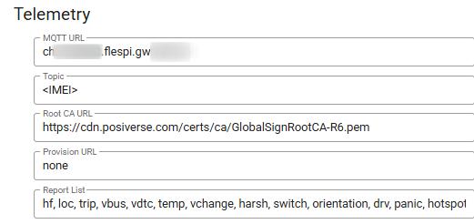

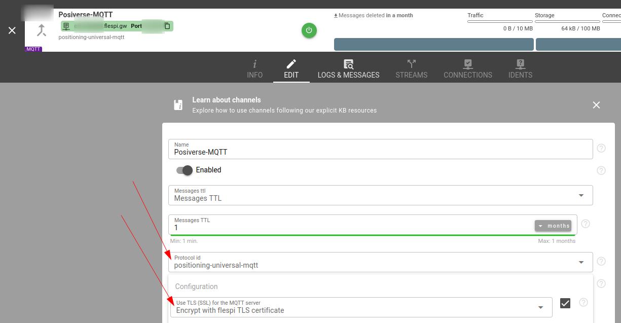

Channel works as MQTT broker. Devices connect to it as MQTT clients and publish telemetry to any topic. To configure MQTT Broker URI use channel's domain:port
To encrypt the traffic using flespi TLS certificate you may download flespi.io root CA certificate and pack it as .pem file or use this link in the configuration (hosted by Positioning Universal team, contact them in case of issues)
