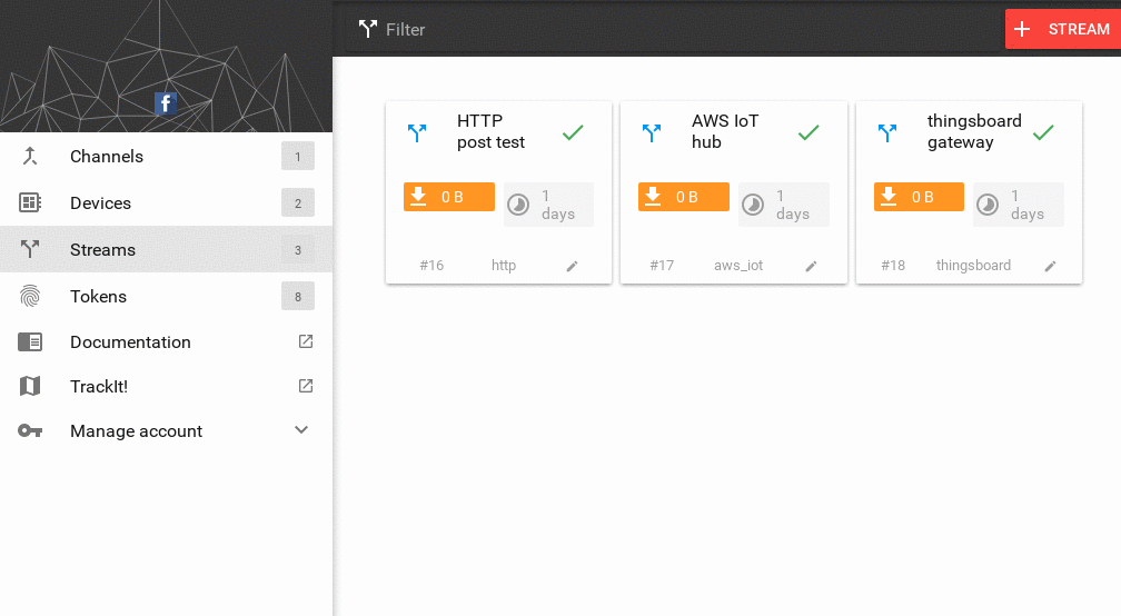

Next, we consider three main implementations of flespi streams: MQTT, Wialon Retranslator, and HTTP.
MQTT
MQTT is one of the most widely used protocols for IoT. Currently, flespi streams support three MQTT-based implementations: Amazon Web Services, Thingsboard, and general MQTT. Here are some tips for each of them:
AWS:
- designed to subscribe for flespi devices. “mqtt_topic” parameter in the stream configuration is used to deliver new messages from flespi devices
- you can find some advice on AWS IoT configuration here
- a single certificate supports multiple AWS things
- “thing_name” parameter in stream configuration applies to update thing’s shadow.
Thingsboard:
- default URI for demo platform is demo.thingsboard.io:1883
- no need to manually create devices on the thingsboard platform: just select “is gateway” checkbox in one new device configuration and set up a stream to this device with “access token.” Thingsboard will automatically create a new device if the message with unknown “ident” arrives.
General MQTT:
- may work with your specific MQTT broker implementation. We have tested it with an open-source Mosquitto.
- we have implemented our own MQTT broker: efficient, distributed and scalable over multiple servers, and featuring a wide range of settings. Give it a try and let us know what you think.
Wialon Retranslator
- protocol description is available here
- default URI for https://hosting.wialon.com is 193.193.165.165:20163
- see some tips on connecting a flespi device to Wialon here
HTTP
- performs POST request with a JSON list of messages as an HTTP “data” parameter
- optional custom HTTP headers are possible
- URI must include the protocol: HTTP or HTTPS
Upon completion of the stream config, you should subscribe it to receive data from devices or channels. Do so by selecting the desired stream in the Streams tab on a channel or device card:
Or use the Devices and Channels tab on the stream card to assign the required instances:
