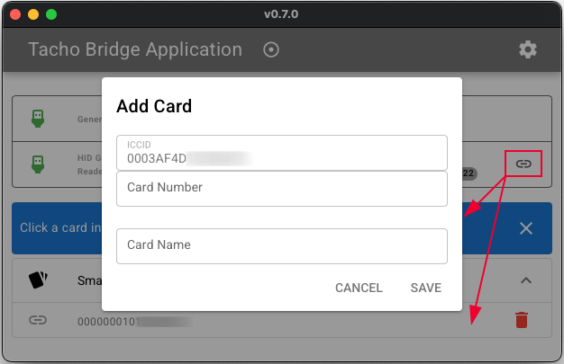

    Cards can be configured in advance, even without physically connecting them: click the Add card button, enter the company card number written on the card (16 characters, as defined by the Annex 1C regulation (EU) 2016/799) and, optionally, a convenient card name.

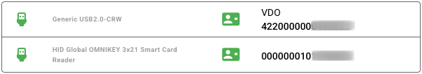

    All cards are shown on one board, grouped by the reader or rack they sit in, with a search field and status filters. An inserted card that is not linked to any configuration yet is shown as Unknown card with its ICCID (Integrated Circuit Card Identification), the unique identifier of the card.
    To link the physical card, click the Link button next to it and either select a configured card and click Link to selected card, or enter a new company card number and click Add and link. After this, the card is shown with its company card number.
    After the first successful authentication, the application automatically reads the card details and displays them next to the card: card generation and type, expiry date, company name and address, and the time and status of the last authentication. The Attention filter shows the cards that expire soon.

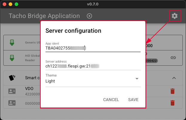

  3. Next, you need to enter the server settings so that the application can connect to the server. The channel where you connect the app should be configured with the tacho-bridge protocol and you should register in flespi the device of type Tacho Bridge App with the same ident in order to see the application connection status in your flespi account remotely. Open the settings by clicking the gear icon in the application header and fill in the "App ident" and "Server address" fields. The "Server address" is the domain and port of your tacho-bridge channel. The "App ident" is generated automatically and has a strict format: the TBA prefix followed by 13 digits, which makes it unique by default; just ensure that you used the same value in the flespi device and installed the Tacho Bridge App instance. When the connection to the server is established, the server icon in the application header turns green.
    If the channel requires Application authentication, turn on Server authentication in the same settings and enter its username and password. With Save to config and use for sign-in the application connects by itself on every start, otherwise it asks for the credentials.

All settings are behind the gear icon in the application header. Besides the server connection and updates, there are:
  • Launch at system startup — registers the application to start with the operating system. Together with the system tray and automatic updates, this lets the application run unattended on a PC with the readers or racks.
  • Extended debug log — a detailed log of what the application does with readers, racks and the server, switched on for a chosen duration and switched off again on its own.
  • Theme and a built-in Changelog viewer.

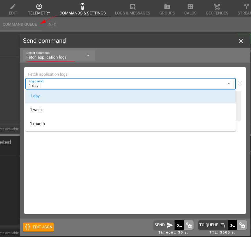

The logs can also be fetched remotely: send the Fetch application logs command to the Tacho Bridge App device in your flespi account, choose the period (last day, week, or month), and the application will upload the zipped log file to the command result.

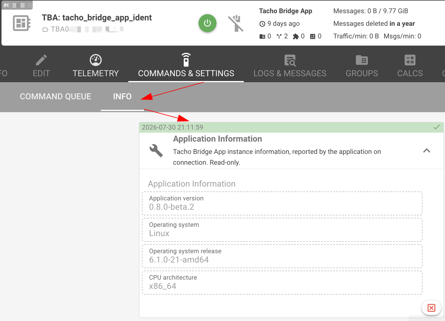

Additionally, the application version, operating system, and CPU architecture are reported by the application on connection and are visible in the read-only "Application Information" section of the device settings.

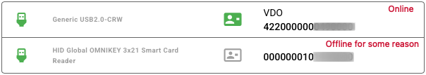

Each card has a status on the board. If a company card is correctly configured in the application but has the gray Offline status, it means the card setup on the client side is valid, but there is an issue on the server side. This could happen if the Tacho Bridge Card device object is disabled, not created, or has an incorrect identifier. The green Online status indicates that everything is properly configured both on the client and server sides. During the remote authentication process the status is Authenticating. An inserted card with the orange Unknown status is not linked to any configured card yet - link it as described in the setup section. A configured card that is not in a reader or rack is listed under Not inserted and cannot be used.
