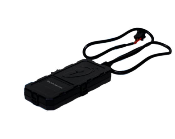

The ITR120 is a compact vehicle GPS tracker designed for easy installation and optimal cost-effectiveness. It features an advanced GPS module, GSM/GPRS communication, and embedded intelligence for processing vehicle data. Ideal for security, redundancy, and logistics operations, it offers functionalities such as ignition analysis, speed alerts, and power disconnection alarms.
