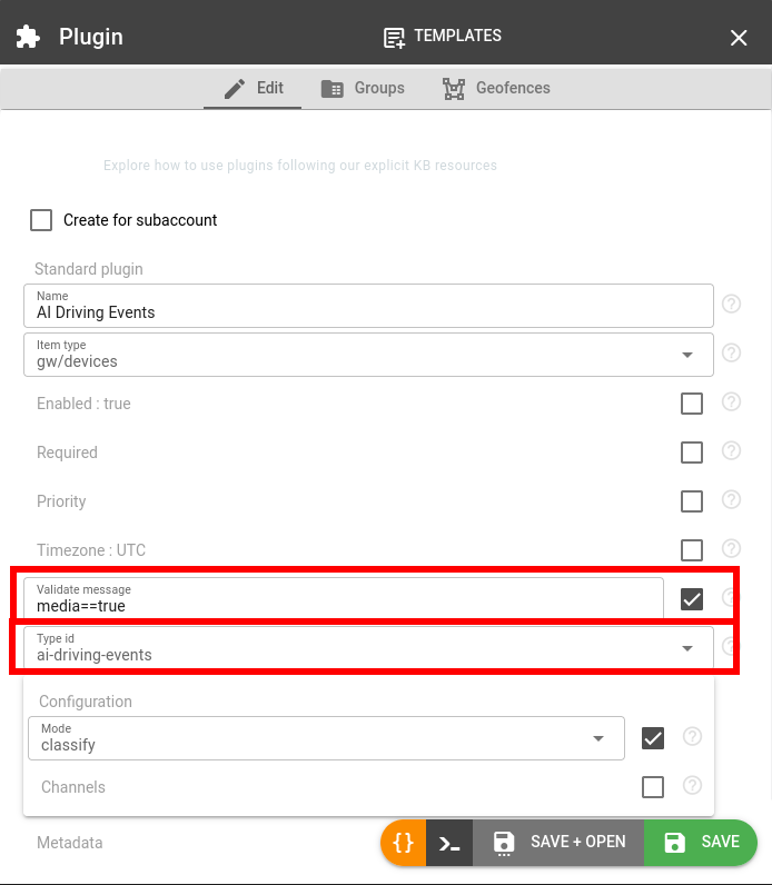

How to use
To create a new plugin, navigate to the Telematics Hub > Plugins section and click on the '+' button. Name the plugin, select 'ai-driving-events' as the 'Type id'. Fill in the 'Validate message' field with the expression 'media==true', so that only messages with media reach the plugin and its log. The expression can be narrower, for example 'exists('media.video.1')'.
ai-driving-events plugin configuration in the flespi panel
The Configuration section of the plugin has two options:
  • Mode: what footage is reviewed and what is changed in the message.
    • 'Verify alarms' (verify, default): footage that comes with an alarm is reviewed, and an alarm with the rejected verdict is reset to false. Footage without an alarm is not reviewed and costs nothing.
    • 'Verify alarms and detect events' (classify): all footage is reviewed. Rejected alarms are reset, and each of the detected events with a high or medium confidence is raised as its standard parameter, for example dsm.driver.phone.event=true, unless the review rejected it as an alarm. A plain camera without ADAS and DSM functions then produces the messages of an ADAS and DSM device.
    • 'Report only' (report): footage that comes with an alarm is reviewed and the review is added, nothing else is changed. Use it to decide on your own, for example in a msg-pvm-code plugin with a lower priority.
  • Channels: camera channels to review, all channels if empty. A multi-channel device uploads a clip from every camera for one alarm: list the channel of the cabin camera to verify DSM alarms, or of the road camera for ADAS alarms.
An alarm with the undetermined verdict is never changed, for example a seatbelt alarm checked against the clip of the road camera. With several files an alarm is reset only when at least one file rejects it and none confirms it. The adas.event.name or dsm.event.name parameter is removed when it is rejected itself, or when all the raised events of its group are rejected. The original claim of the device stays visible in the reported list of the review.
Now assign the plugin to a device: navigate to the Devices tab of the plugin, click on the '+' icon and select the device from the list. Leave the required flag of the plugin off, otherwise a message with footage that cannot be reviewed is not registered at all.

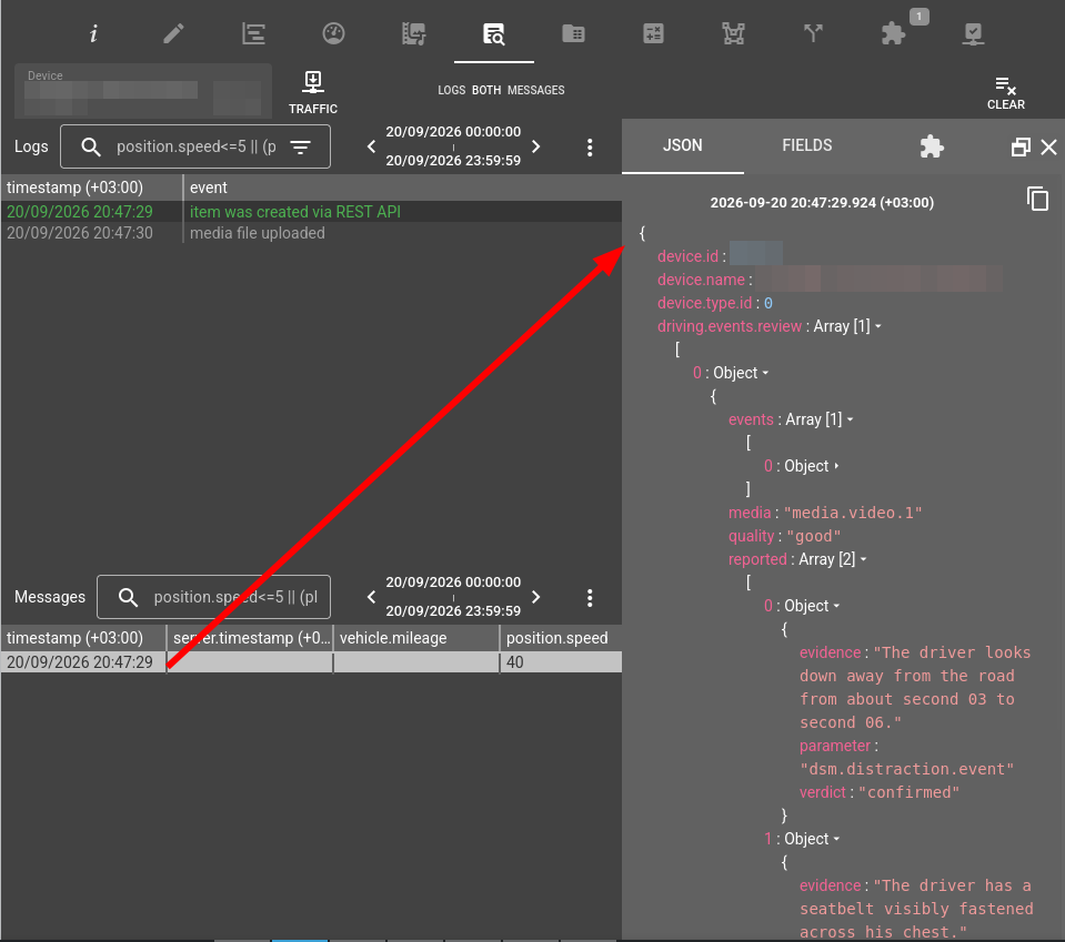

As the device uploads footage, the messages are processed by the plugin. A message of a cabin camera that reported a distraction and an unfastened seatbelt looks like this after the verify mode:
  "timestamp": 1789926449.924622,
  "media": true,
  "media.video.1": {"url": "https://media.flespi.io/XXXXXXXX", "mime": "video/mp4", "size": 154955, "meta": {"channel": 1, "duration": 10}},
  "position.speed": 40,
  "dsm.distraction.event": true,
  "dsm.seatbelt.event": false,
  "driving.events.review": [
      "media": "media.video.1",
      "view": "cabin",
      "quality": "good",
      "summary": "The driver is driving while wearing his seatbelt, but looks down away from the road for several seconds.",
      "events": [
          "parameter": "dsm.distraction.event",
          "at": 3,
          "confidence": "high",
          "evidence": "The driver looks down away from the road for more than 3 seconds."
      "reported": [
          "verdict": "confirmed",
          "evidence": "The driver looks down away from the road from about second 03 to second 06."
          "parameter": "dsm.seatbelt.event",
          "verdict": "rejected",
          "evidence": "The driver has a seatbelt visibly fastened across his chest."
device message with the AI review of driving events
The clip confirms the distraction and shows a fastened seatbelt, so dsm.seatbelt.event is reset. The driving.events.review parameter is an array with one item per reviewed file, media names the parameter of the file. It is absent when nothing was reviewed. The fields of the review are described in AI classification of driving events.

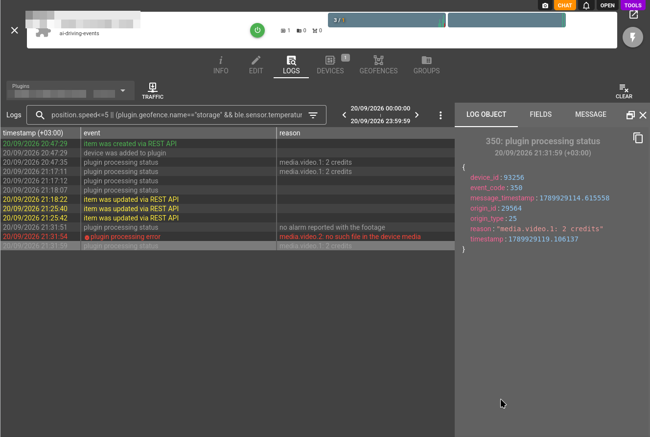

Troubleshooting
What happened to each message is written to the Logs tab of the plugin with the reason:
ai-driving-events plugin logs with the reasons
Reason What it means
media.video.1: 2 credits The file is reviewed and charged, the review is in the message. The log record also carries the ai_credits parameter: the credits charged for the reviews of the message as a number, ready for calculations. The full accounting of the AI credits is in /ai/logs.
no alarm reported with the footage The verify or report mode found no alarm in the message or in the device storage during the footage. Nothing is reviewed or charged. The alarms are looked up in the device storage, so the messages_ttl of the device must not be zero.
media.video.1: no such file in the device media The link does not point to a file of this device: the file is already deleted or rotated out, or it belongs to another device.
media.video.1: Video of N seconds exceeds the 300 seconds limit The tool refused the file, see the reasons of the tool.
media.video.1: Footage is empty The file has no content, usually because the upload from the device has failed.
media.video.1: error: failed to classify the footage A reason that starts with error: is a review that failed on the side of the tool. It is not charged.
alarm lookup failed The device storage did not answer in 2 seconds. The verify and report modes leave the message as is, the classify mode reviews the footage without the alarms.
media.video.5: over the limit of 4 files The message carries more than 4 files. List the needed cameras in channels.
media.video.1: ai credits limit exceeded The AI credits of the account are exhausted. A call needs room for 10 credits at the moment it is made.
media.video.1: ai calls rate limit exceeded The account makes more AI calls per minute than its plan allows. Narrow the footage with channels or the validate message expression.
media.video.1: timeout The review did not finish in 45 seconds and its result is dropped. Such a review may still be charged. The timeout reached reason means the same for the whole message.
media.video.1: connection error
media.video.1: server error
media.video.1: failed to check the file
The tool or the device media storage did not answer. Nothing is charged.
