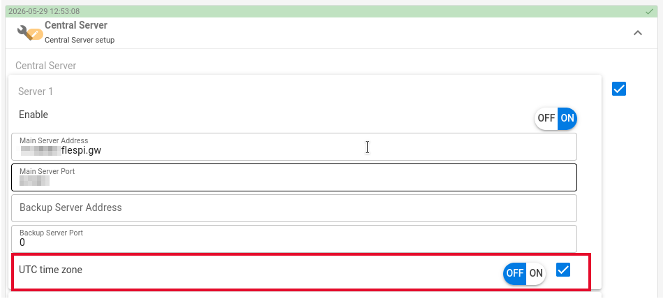

Time zone configuration
For correct timestamps in both telemetry messages and camera videos, configure the following two settings:
  1. Time zone in the Clock setting (Configuration tab) — set this to the device's local time zone:
 This value determines the time displayed in camera video overlays and is also used by the flespi channel to convert device timestamps to UTC.
     2. UTC time zone in the Central Server setting (Connectivity tab) — set this to OFF for the server entry pointing to the flespi channel:
When disabled, the device sends telemetry timestamps in its local time zone, and the flespi channel converts them to UTC using the Time zone value from the Clock setting.
⚠️ If UTC time zone is set to ON while a non-UTC Time zone is configured in the Clock setting, telemetry messages will be registered with incorrect timestamps — the channel will apply the time zone offset to timestamps that are already in UTC.
After changing either setting, make sure the updated value is cached by the platform — simply refresh the settings (click red circle icon at the setting's card) while the device is connected to the platform.
